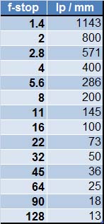

selecting a camera with Autofocus priority - wim - 06-06-2010 Hi Serkan, [quote name='PuxaVida' date='06 June 2010 - 01:41 PM' timestamp='1275824497' post='265'] Wim, thanks for the very "brief" info ... I understand that the high quality lenses produce way better resolutions than the sensor can. But when it comes to the IQ produced, do you think the 120 lp/mm resolution of the sensor is prone to diffraction (even with high quality APO lenses), or do we still have a room for it in there? This question is asked ignoring the fact that 7D is not the best body for wide angle & closed aperture shots, but better for tele& bird shots. I'm playing my "theoretical discussion" card and try to get from you what I can ... Regards, PS: I'm not sure how I could manage not to post this message as a reply to Wim... but it was... anyway, gong live the new edit mode !... Serkan [/quote] All mediums on which we record images and all optical lenses by definition conform to the laws of optical physics, and therefore suffer from optical diffraction. There is a difference between the way a medium behaves and how a lens behaves, but the result is really similar. It is about how much resolution you can get out of a system, at specific criteria, such as contrast percentages, which is what is basically also what is used for MTFs as published by manufacturers. The point where diffraction starts to have an effect is defined by the Rayleigh limit. An example of a table of diffraction limits for lenses based on the Rayleigh limit is: This is relatively simple and straightforward, and based on the formula for the Rayleigh limit, for which often the shortcut formula 1600 / N is used, where N is the numerical aperture. BTW, this table is not as accurate as the numbers may indicate. Round down to the two most significant digits, followed by zeroes if necessary. Note that for most lenses the maximum resolution is obtained about two stops down from wide open, as resolution at larger apertures is diminished or limited by aberrations. Also note that we always have diffraction limits, just that some are higher than we are capable of achieving with photographical lenses. With recording mediums it gets a little more complicated, because now we have to look at it in a 2D way. Difraction by a more or less rounded aperture, causes a diffraction pattern that in simple terms dims the edges of a contrast transition, and adds a kind of reverberation, a circle as it were, with a slightly higher than background density. Instead of straight lines, one gets a a rounded peak, with steeply sloping sides, and a slight bump up on either side of this peak. This is the perfect situation, and a 2-dimensional representation of this is called the Airy-disk. The Airy disk basically defines what we can see still as sharp. If we have two objects next to each other, two contrast transitions, we have to be able to clearly see the difference as it were between the two Airy disks that are generated due to diffraction. the size of the Airy disk is determined by the Rayleigh limit, and its radius is equal to 1/(Raleigh limit). In order to be able to see the transition from one to the other, they have to be spaced far enough apart to be distinguished independently, at a high enough difference of contrast. The latter is taken care of by the Rayleigh limit, because its formula takes a 9% contrast into account, therefore also in the Airy disk size. We now see calculations where diffraction based on Airy disk calculations tells us that diffraction effects are visible with the 7D from F/7.1 and smaller apertures. However, I think I can make things simpler. A sensor can resolve a maximum of 0.5/(pixel spacing) , the Nyquist frequency IOW. I've already expressed that as approximately 120 lp/mm - line pairs take the Nyquist frequency into account; you need two contrasting lines in order to distinguish anything at all. If we now take the Rayleigh limit, 1600/N, and we work out what N is at a Rayleigh limit of 120 lp/mm, we get approximately F/13 (F/13.3). There is another way to calculate th eaperture wher ewe hit the diffraction limit, and that is N = 3.2 * (pixel spacing), where N is aperture and pixel spacing is to be given in µm. Calculating it this way gives a result of F/13.7, which is close enough to F/13 anyway, considering the accuracy of pixel spacing (2 digits). Notice we now have a considerate discrepancy. Where does this come from? Well, for one the criteria are different. As I mentioned, the Rayleigh criterion is based on 9% contrast, and most calculations by lens manufacturers these days are based on lines at 50% contrast. Considering that a lens at F/7.1 manages 225 lp/mm, and that the 7D manages 120 lp/mm, we would expect a maximum system resolution, at 9% contrast, of 1/system resolution = 1/(lens resolution) + 1/(medium or sensor resolution), or approximately 78 lp/mm as system resolution. At F/13, that would be about 60 lp/mm. So what is this diffraction limit stuff all about then? Essentially really that you are limited by diffraction, not the sensor resolution anymore. The same is true with diffraction limited lenses. When a lens is diffraction limited, it just means that you can't get a higher resolution out of it than the diffraction limit allows you. It is so good that it will resolve the diffraction limit, but due to the laws of optics it just can't resolve more. If this theoretical limit is reached at F/7.1 for the sensor in the 7D, fine. Ideally I would like a sensor to have a diffraction limit as high as possible, because it means I could potentially record the finest detail possible, be it only at large apertures, just like it is the case with lenses. So, does this mean we can't take good and sharp pictures at smaller apertures? No of course not. It only means that the maximum resolution will be reached at that aperture, but we had to contend with that with our lenses already anyway. What is limiting is the maximum size we can enlarge to, before the picture becomes unsharp to the eye, at certain distances. So, this doesn't stop us from making sharp or good photographs at smaller apertures than F/7.1. The 7D just ups the ante a little, that is all it means. Other cameras just can't resolve as much is all this says. Does this mean you have to use the best lenses possible in order to use the 7D? No, but if you want to get the last little detail out of this camera, you may want to use the best and sharpest lenses available. Do note that most of the prosumer lenses offered by Canon and other manufacturers, and even the consumer ones, are quite a bit better than most stuff available 30 years ago <img src='http://forum.photozone.de/public/style_emoticons/<#EMO_DIR#>/biggrin.gif' class='bbc_emoticon' alt='' />. Ok, another short reply <img src='http://forum.photozone.de/public/style_emoticons/<#EMO_DIR#>/biggrin.gif' class='bbc_emoticon' alt='' />. I think I should not make a habit of this <img src='http://forum.photozone.de/public/style_emoticons/<#EMO_DIR#>/biggrin.gif' class='bbc_emoticon' alt='' />. Kind regards, Wim selecting a camera with Autofocus priority - toni-a - 06-06-2010 Frankly wim I don't mind at all your exhaustive replies, however they will become more practical if they are in paragraphs with a title for a each paragraph. Anyway, resolution isn't a question I really care for, I made excellent prints from 18-55 kit lens, i had a photo expo, the picture that took most sucess was taken with Canon 75-300 f4-5.6 sometimes we concentrate on small daetails and forget the essential your lens could be the best lens that ever existed if your picture is out of focus you have a blurry picture selecting a camera with Autofocus priority - Brightcolours - 06-06-2010 Diffraction is "caused" inside the lens, and is related to just how small the hole is the light passes through, and the distance from the hole to the sensor or film. ALL APS-C cameras will have the same softening from diffraction at the same settings and the same lens, no matter how high the resolving power of the sensor is. So... a 6mp EOS 300D will have the exact same diffraction "hit" on the image as an 18mp EOS 7D. So.. it can NEVER occur that you will have an image from the 300D that you are happy with in terms of sharpness (or rather, lack of softness) printed at a certain size, where you are not happy with the sharpness of a same image taken with a 7D. The only thing that happens when you have a higher resolution image is that you get more detail, including more detail in the softness from diffraction. It is only when you have an image from a 300D that you print at a size where the (lack of) resolution starts to show, where you then would start to also notice that the 7D shows a softness due to diffraction. With lower resolution sensors, it is the lower resolution masking the diffraction. It is not that with higher resolution sensors you get more diffraction. So, this means that a sensor NEVER can get too high a resolution, in respect to diffraction. Diffraction always will remain the same for the image. You only gain with higher resolution (possible detail), but you never lose anything compared to lower res. sensors. Switching to full frame also will not be a solution to limit diffraction, because with full frame you will have to close the aperture down (by a factor of 1.6, compared to a 7D) to get the same depth of field, and the smaller aperture then will give more softening due to diffraction. Remember that it is about the image, not about individual pixels. [quote name='PuxaVida' date='06 June 2010 - 12:41 PM' timestamp='1275824497' post='265'] Wim, thanks for the very "brief" info ... I understand that the high quality lenses produce way better resolutions than the sensor can. But when it comes to the IQ produced, do you think the 120 lp/mm resolution of the sensor is prone to diffraction (even with high quality APO lenses), or do we still have a room for it in there? This question is asked ignoring the fact that 7D is not the best body for wide angle & closed aperture shots, but better for tele& bird shots. I'm playing my "theoretical discussion" card and try to get from you what I can ... Regards, PS: I'm not sure how I could manage not to post this message as a reply to Wim... but it was... anyway, long live the new edit mode !... Serkan [/quote] selecting a camera with Autofocus priority - toni-a - 06-06-2010 [quote name='eltoucan' date='06 June 2010 - 11:30 AM' timestamp='1275813047' post='263'] Even if money is not an issue, the weight can become one. That is the reason why I took the 7D over the 5D. And I still find my system too heavy. Weight is actually stopping me each time I consider the 17-55IS. [/quote] Well 5D is not much heavier than 7D however 17-55 is so darn good, till now there's nothing equal to it, alone as you suggested it is a reason to go for 7D instead of the . Things are getting clear now selecting a camera with Autofocus priority - mst - 06-06-2010 [quote name='toni-a' date='06 June 2010 - 08:06 PM' timestamp='1275851189' post='284'] Well 5D is not much heavier than 7D [/quote] But full frame lenses are usually heavier than crop lenses. That's where the weight issue crawls in. -- Markus selecting a camera with Autofocus priority - Brightcolours - 06-06-2010 [quote name='toni-a' date='06 June 2010 - 08:06 PM' timestamp='1275851189' post='284'] Well 5D is not much heavier than 7D however 17-55 is so darn good, till now there's nothing equal to it, alone as you suggested it is a reason to go for 7D instead of the . Things are getting clear now [/quote] Well, the weight of the lenses makes a 5D more heavy, for a comparable focal length. However, do take into consideration that an equivalent lens to an f2.8 lens on APS-C is an f4 lens on full frame (or to be more precise: f2.8 x 1.6 = ~f4.5). The Canon EF 24-205mm f4 L IS USM comes pretty close to being equal to the EF-S 17-55mm f2.8 IS USM. In areas it actually surpasses it (for instance focal range). Of course, a standard zoom is NOT the kind of lens to base a sensor format on. In my opinion. selecting a camera with Autofocus priority - toni-a - 06-07-2010 [quote name='mst' date='06 June 2010 - 11:04 PM' timestamp='1275854692' post='291'] But full frame lenses are usually heavier than crop lenses. That's where the weight issue crawls in. -- Markus [/quote] Well 7D plus 10-22 plus 17-55 is merely the same as 5D plus 17-40 or 16-35 plus 24-70 or 24-105, for the tele end , they will use same lenses, I know 24-70L is heavier than 17-55, but the difference isn't that important. but I am speaking in Canon land and about lenses I wanna get, maybe for some other gear there's some difference. Image quality speaking I found no difference, I rarely print bigger than 30X45cm , seeing that crop cameras are being very well performant on the side of ease of use and autofocus, with an unnoticeable difference in image quality, with the presence of the magnificient 17-55 IS with no equivalent in full frame world, it seems things are clear for me <img src='http://forum.photozone.de/public/style_emoticons/<#EMO_DIR#>/smile.gif' class='bbc_emoticon' alt='' /> unless something shows in the upcoming months. selecting a camera with Autofocus priority - HarryLally - 06-07-2010 From my limited personal experience with the 7D and things I have heard from others using the camera it seems to me the 7D is easily the best and most professional APS-C EOS to date. -- Markus [/quote] ,,,And yet...Klaus has made an adverse comment or two about the 7D's IQ here and there has been quite a number of criticisms of its IQ by users over at dpreview, particularly concerning low ISO noise and banding. Tylerken, who hosts the wildlife thread on the Canon Lens Forum on dpr (and is a top bird photographer) bought one to shoot BIF with his 500 f4L IS and was pretty dissatisfied with its IQ (not the AF). So he sold it and got a 1D MkIV. Not that I suggest Toni-a should do the same. Michael PS. Don't understand this new forum. I see I'm down as a newbie but have been posting here for nearly 5 years. selecting a camera with Autofocus priority - mst - 06-07-2010 [quote name='HarryLally' date='07 June 2010 - 07:58 AM' timestamp='1275893891' post='295'] ,,,And yet...Klaus has made an adverse comment or two about the 7D's IQ here and there has been quite a number of criticisms of its IQ by users over at dpreview, particularly concerning low ISO noise and banding.[/quote] Well, yes, it wasn't probably the best idea to cram 18 MP on that sensor (but see Wim's extensive post about this, too). My comments were largely about the body, haptics, viewfinder, feature, AF, etc. ... [quote name='HarryLally' date='07 June 2010 - 07:58 AM' timestamp='1275893891' post='295'] PS. Don't understand this new forum. I see I'm down as a newbie but have been posting here for nearly 5 years. [/quote] Only the login credentials were transferred, but apart from that the new forum is a cut and fresh start, we all began as newbies here last week. -- Markus selecting a camera with Autofocus priority - PuxaVida - 06-07-2010 Thanks Wim... I'll save these two posts... Do you have a blog or something like that which you share your knowledge? Serkan |
