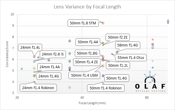

Complexity is a bullshit weighted composite of groups, autofocus method (i.e number of cams), IS, tilt-shift, aperture, number of aspheres, and a focal length componenet.  There is a trend but I don't know how meaningful it is.

[Image: VarianceByEFL.png]

Dave, how much would you bet you got a perfect copy of that fisheye?  I bet it has issues a camera sensor can't see! =)
Seriously, I've measured 12 copies of the 14mm, 10 of the 24, 10 of the 35, 10 of the 50, and 10 of the 85 and I have not once seen a samyang without some problems.
