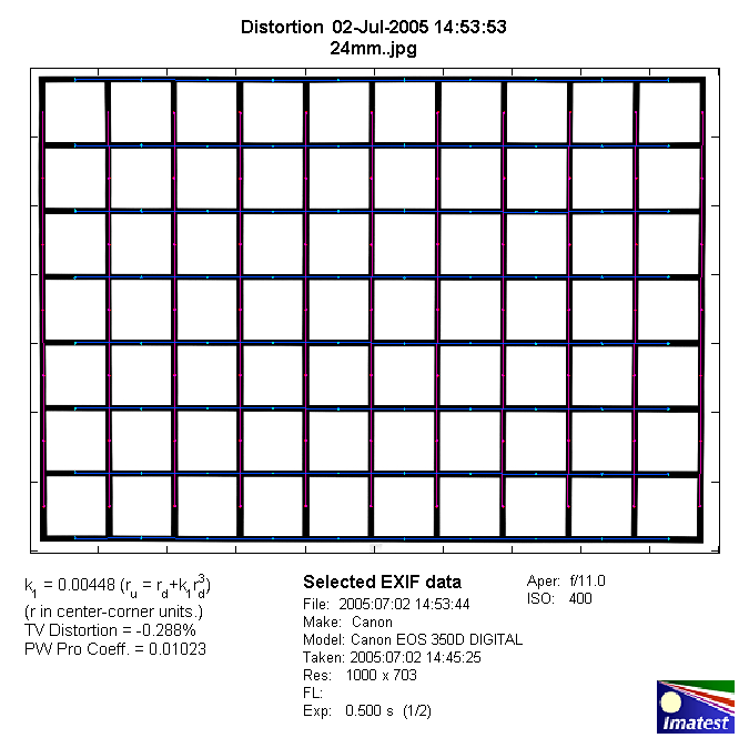

Personally I have used a Tokina 12-24mm f4 , which has very little distortion, in the range of about 20 to 24mm. Here the distortion graph at 24mm:
![[Image: 24mm_distortion.png]](http://www.opticallimits.com/images/8Reviews/lenses/tokina_1224_4/dist/24mm_distortion.png)
