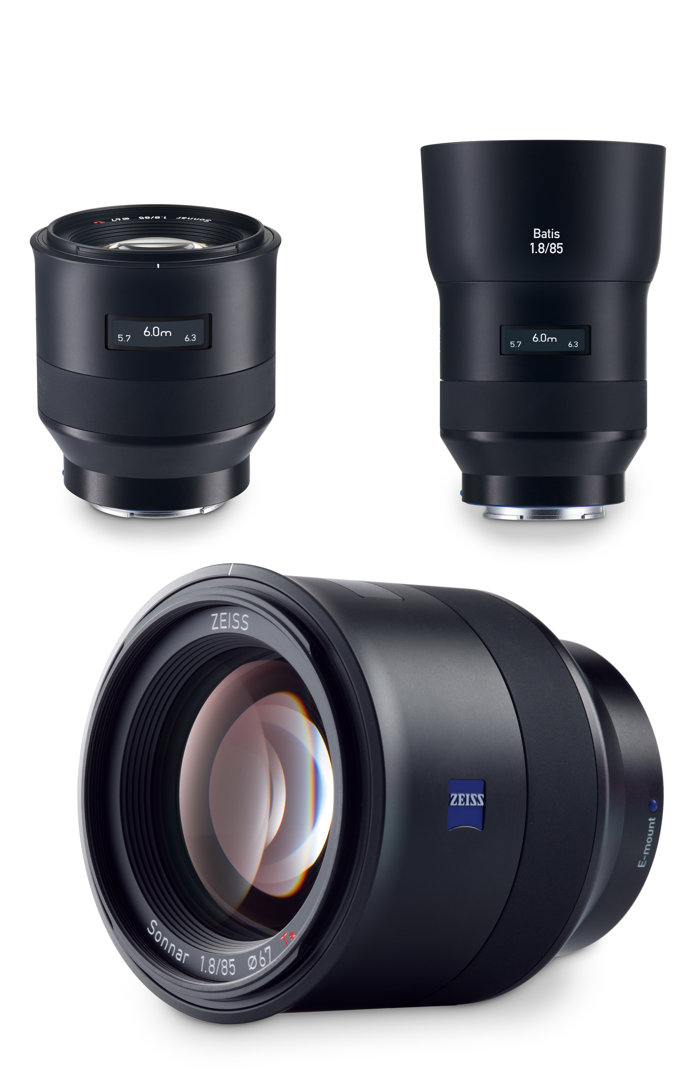

Guys, look a bit closer. As with more or less most modern lenses there's a small window in the barrel:
[Image: pi-0056-2015-batis-1-8-85.jpg]
To me it looks like a LCD of it's own, but maybe its' just an ordinary printed scale Smile

It clearly is not a printed scale.

That is the "OLED Display" that has been mentioned.  I believe that it shows the focus distance in the large central number and the DOF range in the smaller numbers.
