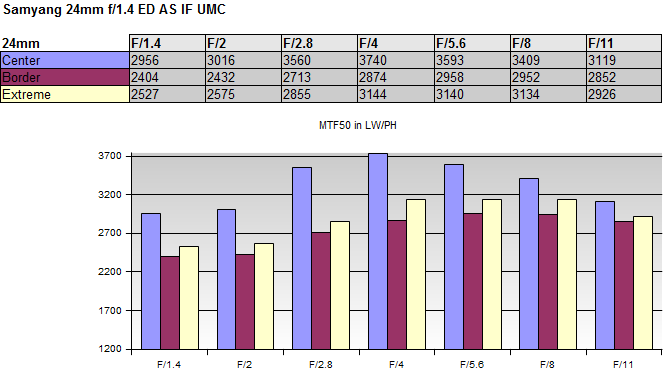

By the way, I just had a question for you gurus regarding the 24/1.4 lenses by Canon and Samyang - or, to be more precise, regarding the PZ tests of both.
[Image: mtf.png]
The resolution graph for the Canon L implies that the IQ drops off the cliff at f/1.4 when it comes to the outer region. Fair enough; that is to be expected in a lens of this class. But then, there's the Samyang:
[Image: mtf.png]
It has a completely different curve with smoother center resolution increase but way better corners. Is it really THAT better than the L?
P.S. The negligible amount of increase in IQ when going from f/1.4 to f/2 really seems to substantiate the theory suggested by Lenstip that the Samyang is not really a f/1.4 lens, more like f/1.8.

#12
The 24L is limited by primarily sagittal oblique spherical.  Coma grows by x^2 as you move away from the center so the performance will quickly "disappear" at wide apertures.  Coma is typically targeted for correction, often eliminated with an asphere, but sagittal oblique spherical is very difficult to correct.
Samyang's lens is limited primarily by strong spherical aberration and astigmatism.  The spherical grows by y^3 as you increase the aperture size so it hampers the performance of their lenses wide-open in the center but they quickly improve.  The astigmatism varies by y as you increase aperture and x^2 as you move away from the center so it is harder to correct by stopping down.
