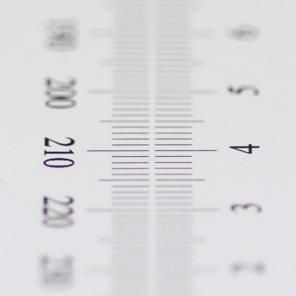

Longitudinal Chromatic Aberration:
[Image: 112201361.1XzJrAZc.chromatic_1524.jpg]
LoCA from Canon EF 100mm f2.8mm macro:
[Image: f28.jpg]
Photosites do not "react" to eachother, LoCA is lens dependent. PF is lens dependent too, and seen mostly with cheaper compact digital cameras. Manufacturers have made changes in back element coating to combat PF, Sigma has introduced the DG(DC) line and Tazmron the Di(Di II) line specifically for PF (not LoCa). Nowadays you do not see PF very often anymore. You do see a lot of LoCA still, specifically with wide aperture lenses and macro lenses.
LaCA ("normal" CA) is mostly seen with standard zooms and wide lenses, but also with other lenses. Some brands show laCA more (often) than others (Nikon, Tokina, Pentax come to mind).
  Reply
